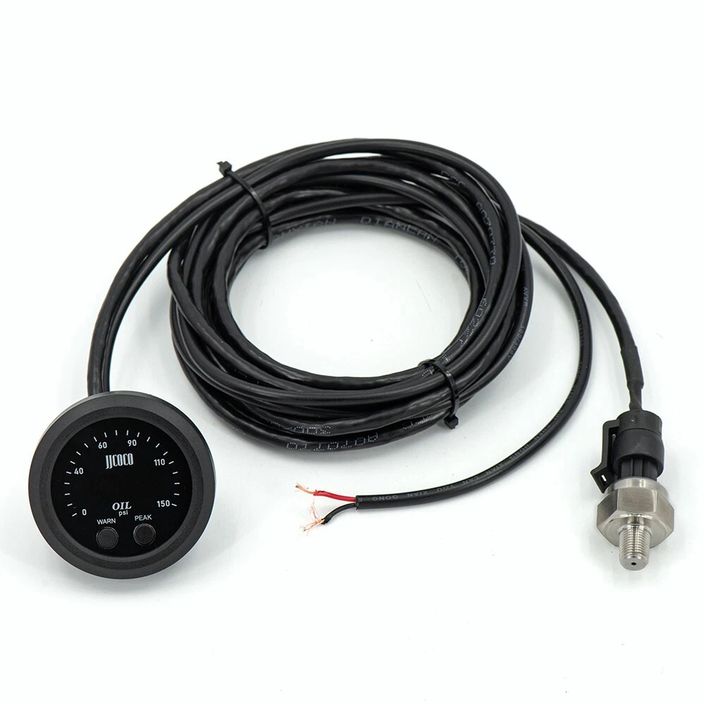

    Yes seems like the ideal unit would be an electronic sender that screws directly into the Schrader on the motor with a wire going up to the dashboard gauge...anyone know if one that would work like that?

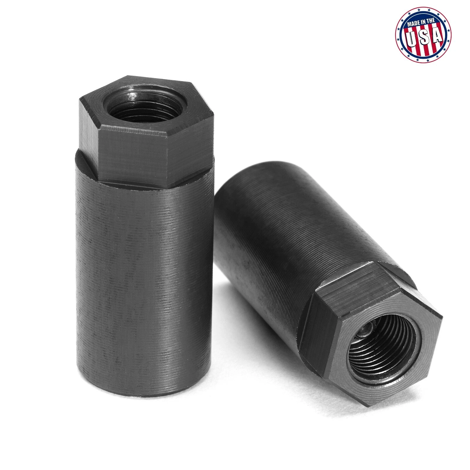

    Maybe something like this ?? with adapter for the schrader
  16. Likes David - WI, KIRCHNER liked this post

    Will those work?

    i went through two of those before i gave up and went ta mechanical.... they jus didn't last very long.
