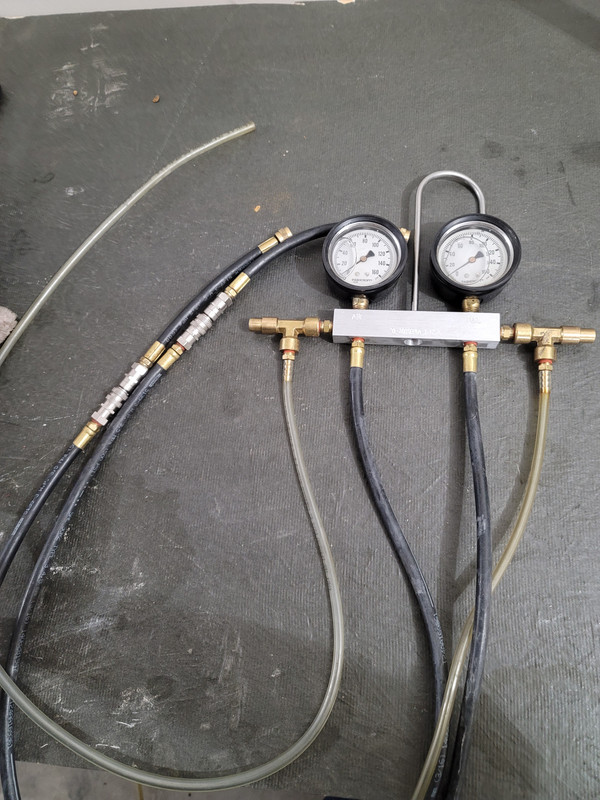

    I find people often have a hard time diagnosing the Optimax fuel systems. This is usually paired with a lack of tools, and not wanting to buy a $600 set of gauges.
    I'm wondering what you guys would be willing to pay for a set of Optimax fuel and air pressure gauges. These gauges would be very similar to the Merc gauges, but with a few differences.
    1. There would be no quick disconnects, I just don't see the need for them.
    2. The aluminum body would be HDPE. I'm thinking about doing this for a few reasons. One being cost, the other being it is easier to work with, and won't scratch paint etc.
    The hose length would be the same as the Merc gauges, I could always do custom lengths, maybe something long enough to view at the helm?
    The gauges would be the same exact ones as the Mercury gauge set. No cheap knockoffs. I also want to have the option for a 4" gauge size, up from 2 1/2"
    You could use these gauges on any outboard, but they are specifically designed for Optimax motors.
    Here is a picture of the factory Merc gauge set. As I said, mine would be very similar in appearance.
    Let me know your thoughts on these. If your seriously interested pre-orders would help with the first run of these.

    I'm thinking these will end up around $300 USD, to your door. It is coming out to more than I was originally anticipating, but I feel like that is still reasonable considdering. For example, Harbor Freight's fuel pressure test kit, is $50. Thats for their kit with the fuel bleed off valve. That is for a single, low quality, non-liquid filled gauge (which doesn't do you much good at all). So for essentially 2 gauges, with hoses, quality gauges, and bleed off valves, I don't think its too bad.
    EDIT: The Snap-On basic kit lists for $320 as well. I know you can buy them for less depending on the driver/deal, but it gives you an idea. Basically Merc, or Snap-On, your paying $600 for gauges to test an Opti.
    I don't have final numbers as I am waiting on some quotes for pressure gauges. Right now I have only looked at and considdered the Ashcroft brand. They are fairly expensive, but its what Mercury uses on theirs. Before commiting I will look at a few other brands of gauges. I don't want any eBay/Amazon stuff though.
    Merc also uses the 1008 series gauge. I am thinking I will offer the gauge set with either the 2.5" 1008 gauge (or equivilent), as well as a set with the more accurate 1009 gauges in a 3.5"
    Let me know what you guys think. I'm open to suggestions, ideas etc.

    Ashcroft or Wika both make good gauges. I used 4.5" Wika gauges for both my nitrous/fuel flow and I would buy those cheap tire pressure gauges and throw the gauge away and put a 1% certified gauge in its place.
    They worked great until someone left the gauge on a tire, forgot and pushed the car,
    then ... not so much .
    Problem with gauges is .. you can buy reasonable quality, for fair money. And you can get carried away and spend over $1500 a piece on some made out of unobtanium.
    The rest of what you have there could be easily done with push-lock connectors and hose. McMaster-Carr has it all but I also use https://www.usplastic.com/ for some of the stuff I need to do soft line nitrous kits .
    Just a thought ...

    Usually right before they find out about the holes in their pistons. The day the last optiflop rattles to it's death will be a day of celebration. Anyhoo I made my own gauge set for around $250.00 ten years ago or so. Not terribly difficult and you should be able to sell some if you can half the retail cost.
