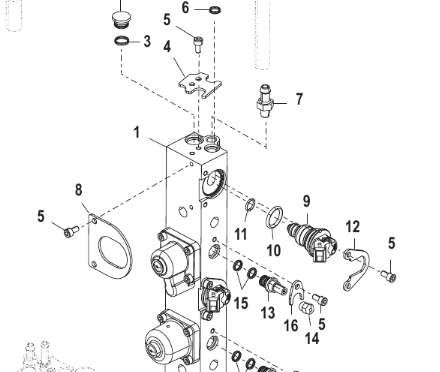

    #11 On This Diagram
    The teflon seals would be on the air or direct injector which is not pictured here.

    That part number would be on the fuel injectors smaller o-ring. I just looked it up, what merc wants for these things is quite a lot. Do you have an injector shop near you? You in a rush? If not Ill send you 6 free of charge.
    #11 On This Diagram
