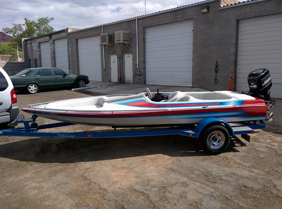

    Not to hijack this thread, but I was thinking of trying skiing next summer with our 1987 2.0l 150hp in this boat:
    It's 18 feet.
    Think this ought to work for deep water starting a single ski? Not a skinny competition ski. Just a wide recreational ski.
