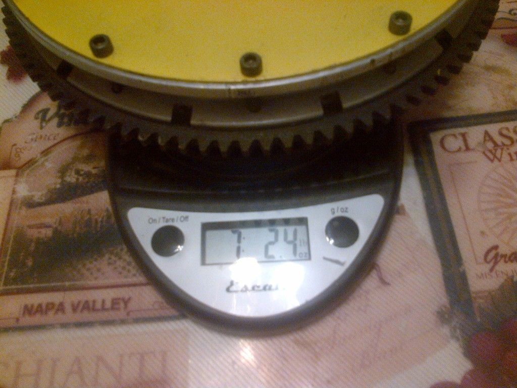

    As far as why different light flywheels weigh differently?? That can be attributed to many factors. Were they done by the same person, Same machine with the same program? Diamond, Brendan, Jay Smith, Jeff Dunn all cut them differently therefore there is going to be a weight difference. Even if two wheels were done on the same machine with the same program. After balancing they will be different weights if only by a few Grams.
    As far as a 1/2 lb not being ultra critical?? Well Myself as well as others spend alot of time and or money to remove ounces and even a few grams from Pistons and Rods to make sure they are all matched in weight and lighter than stock.
    But for River Running purposes IMO its best not to Run a Lightened flywheel. The Up and down Flex due to RPMs will eventually cause stress cracks in the Magnets and possibly the Flywheel itself. Now if its a Billet Flywheel with encased magnets one has a better chance of that not happening.
    This is a Stock mercury Lightweight Flywheel At 7.24lbs which is about average weight +- a few grams vs a Flywheel Jeff Dunn and I did for one of my race engines at 4.10 lbs.
    Quote Originally Posted by Krazymaan View Post
    I know everyone doesn't have a digital scale. But I would like to see real life numbers. I'm always interested in why does your lightweight flywheel weighs 4.2 lbs and why does another lightweight flywheel for the same motor weigh in at 5.4 lbs. and they are supposedly the same flywheel. I'm betting its because thats what the buyer was told without real evidence. I know 1/2 lb isn't ultra critical, but its just interesting to know why it is what it is. Maybe they are all rough cut pretty close and the other grams are from removing material during balancing. I don't know but I am sure someone knows.
