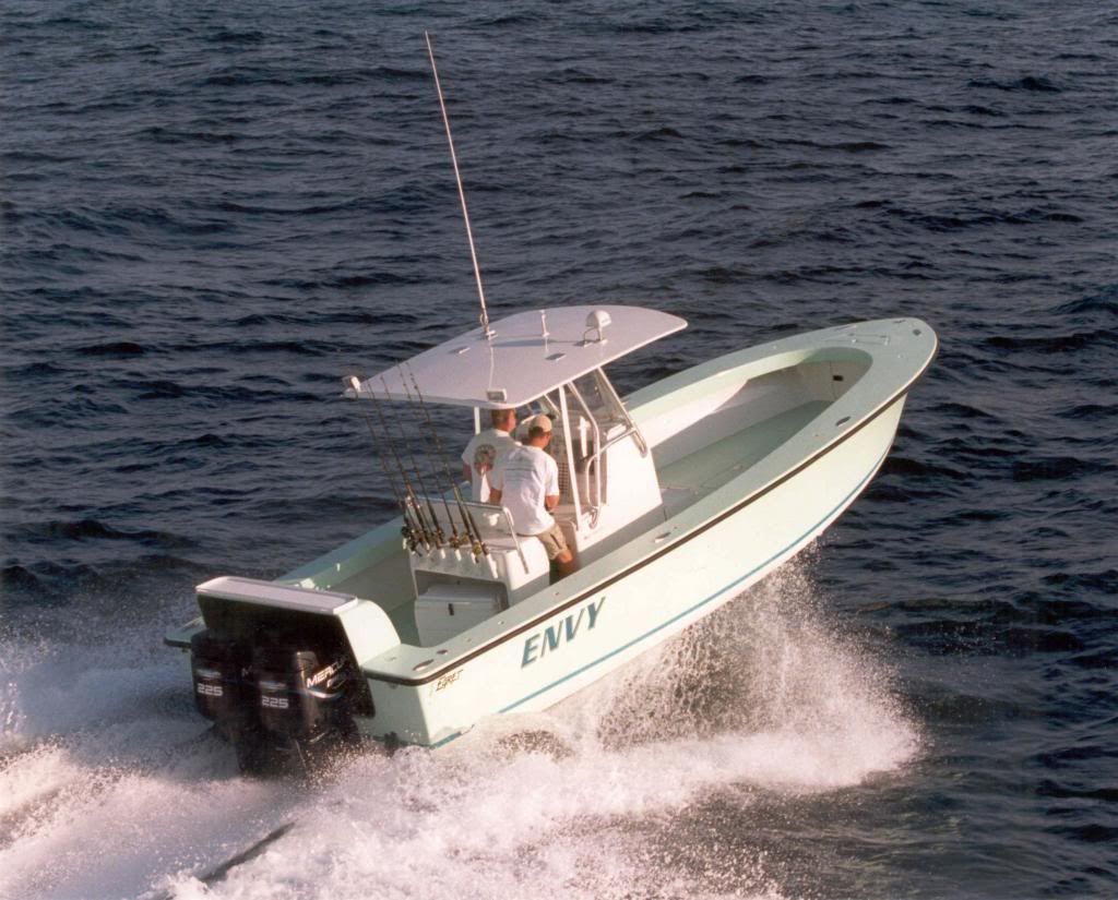

    This motor cover is good for a 3-4 mph........Reduction. Makes the 29' fishing boat I built almost 20 years ago really quiet but slower. How are those Merc's breathing?

    408
    I remember running your 29" out of Lauderdale one time - hit a roller and kited it! Awesome boat - as were all your boats. Don't remember that motor cover - bet the suction back there salted them black motors like a bag of salted peanuts!!! What's going on over at Fountain these days - they building anything?

    Yes Bernie that was a good ride. Its the Winds fault, not mine that a light boat likes to fly. :-)
    The motor cover was not my idea, I saw them on a Conch 27. You cannot hear the engine running and the customer wanted a place to cut bait. I don't recall the vacuum causing a problem, but I built it and it went away. The weirdest effect I ever saw was my 16' flats boat prototype. I took one of the Mechanic's for a spin after work. Sitting on the deck beside me somewhere above 50 mph the beer he was holding started to snake out of the can like a cobra. He tried to catch it in his mouth and the stream collapsed in his lap. I said "lets do it again" and he chugged it!
    I am all about Catamarans for the moment, but what a pain in the ass to laminate, expensive in labor and materials too. We are getting really good fuel economy numbers, soft ride, speed and stability. I think it's worth it, just need the customers to "buy in" !
    I think they are shipping a few Proline's and Fountain's each week. Not sure about Donzi's and Baha's. They also shipped a 30' race boat. They molded a Plexiglas windshield for a catamaran I am building a few weeks ago. Nice guys, wish them well.
