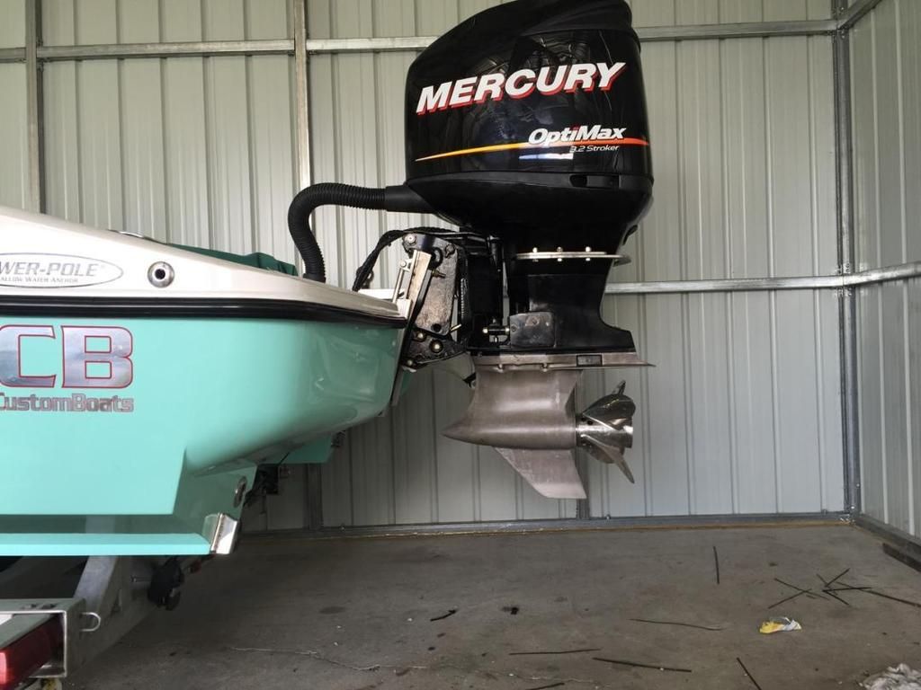

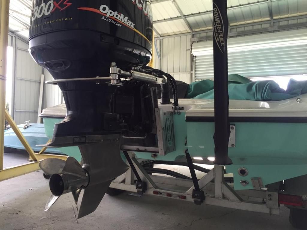

    I know it's a 300xs ... but ?
    From the back ....
    i'm I looking at this prop wrong or is the trailing edge of one blade cut forward like a sharks dorsal?

    "They say" you cant put a 15" can and a three ram clamp together ...

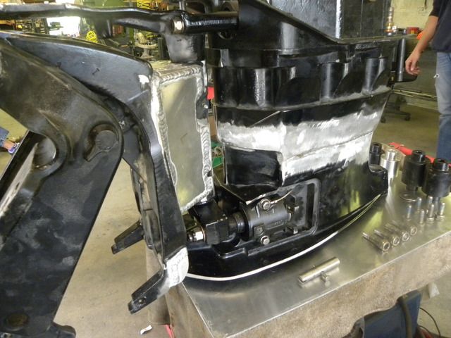

    This is a LCB owned by Paul Brown of Browns Performance Marine in Immokalee Florida. He converted his 20" 300xs to a 15" using the factory can and 3 r am trim. The mid modifications are complements of Chaz custom fabrication!
    Thus boat ran just under 90 fully loaded with the family to go fishing. It ran mid 90s light and will run over 100 once the setup has been tweaked!

    Todd instigated .. err .. designed that .. I want three ram trim , standard can cut to 15" , and 4" of setback built in ...
    Aahhhh yea ... no problem

    We have done 6 of them like that so far . I think this is the one though ..
    Paul did a great job of completing this boat ..

    Did the additional setback actually make it easier to do? Looks great.
  20. #15
    I love looking at Chaz's welding, wish someone around here was half as talented.
