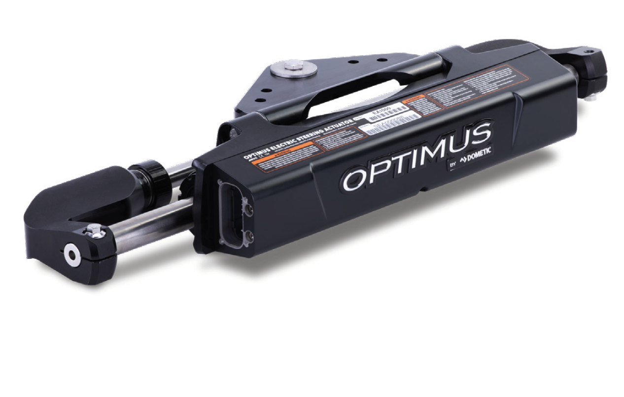

    I'm gonna try the Optimus electric steering by Dometic

    That looks interesting Noli, any idea what PSI that puts out? I wound up going with Mercury Verado Gen C power steering pump and 40cc told helm going to the UFLEX silversteer cylinder, hopefully its solid.

    Hi K,
    There is no pressure measurable like the hydraulic system does
    The rod inside the actuator is being pushed/pulled electro-magnetically
    If you can visit a boat show soon, the Dometic engineers can better explain than me

    Quote Originally Posted by noli View Post
    Can you even buy that for a single? Can't find any info online other than promotional.
    I ended up with the Uflex UC130 and 2.0 Helm for fewer turns lock to lock.
    K-WELLS, personally I don't think you'll need power steering with that 1.5 helm you'll have 5.3 turns lock to lock and effort will be low.

    Do not use electronic .I have been installing on some autonomous boats and it does not respond fast enough for a v bottom.Failure rate is more than hydraulic also.Give me a ring Noli i can go into more detail.

    Thanks for the heads up.
    I will call you
