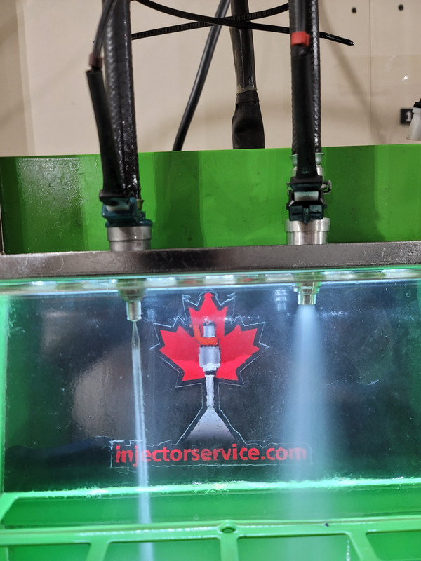

    Quote Originally Posted by InjectorService View Post
    Here's a picture of the spray pattern on the 0 280 150 036 vs the replacement I'm working on.
    Your working on ? 🤨

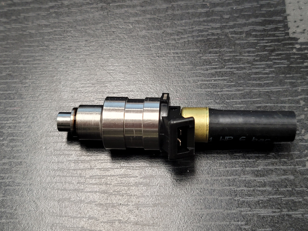

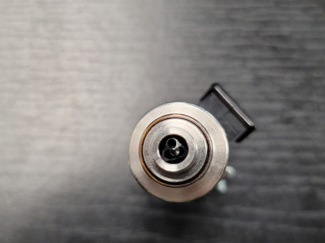

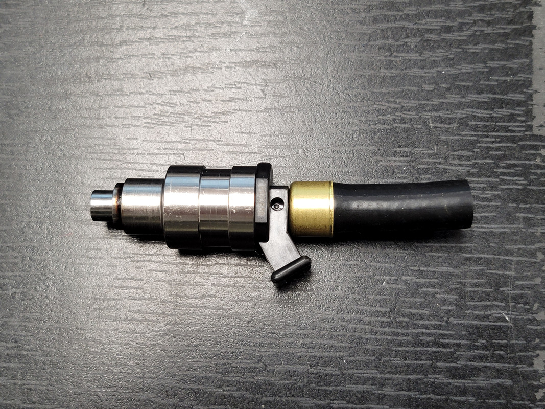

    I got the SMP injectors in from Rock Auto. A few observations.
    These are heavy. Usually on a more modern plastic bodied injectors this is a good indication on whether you have a knockoff or not, as the weight you feel is mostly the coil. This is a different case, with the body being all metal, but it definately can't hurt that there is some heft to these.
    The machining all looks to be consistent and well done, the welding of the pintle snout is consistent, the plastic molding looks clean, and the part number etching is clear and consistent. The ferrules fit nice, and they come with a new hose clamp. It appears there was at least some care when making these.
    They also say Made in USA on the box. I'm a little surprised to find that they don't boast this claim more on their packaging and don't mention it on their website that I can find. Usually a Made in USA product would be somthing heavily advertised for the preceved quality, but these don't do that. That worries me a little, but who knows.
    Things I don't like:
    They have completely changed the pintle area of these injectors, they will definatley have a different spray pattern, which could be good, or could be bad, we will see. I think it would be a tough task completely redesigning the whole pintle area and maintaning the same flow rate as the originals.
    The other thing I don't like is that the bodies are all beat up. Its clear these things have been tossed in a big pile and handled rough. Thats something you would expect out of a Chineese knockoff. You don't handle a quality injector that way, and you don't handle a product you are proud of in that way. I've got a pile like that of scrap injectors, but you won't see me tossing around a new injector or customers injectors. They do all of that, just to box them individually again, why don't they ship them in bulk?
