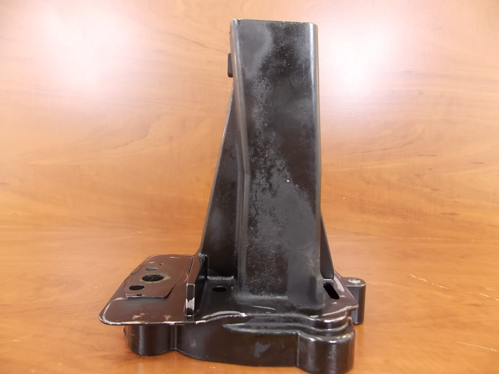

    And as you can see there is a Significant difference in the Adapter Plates. First Picture is a 2 piece Adapter Plate for a 1997 FF Block. Second is a 1 piece Race Adapter Plate.
Name:	Bass mid Adapter Plate.jpg
ID:	487823 Click image for larger version.
Name:	Adapter Plate d.jpg
  18. Thanks LakeFever, rprinzo thanked for this post

    No The 225 Pro Max doesnt come with a 1 piece plate.
    Quote Originally Posted by LakeFever View Post
    Great stuff Bud!! Is that one piece oval plate the same one that comes on the 225 promax?
    The oval port one piece plate looks similar in width its the oval length of the holes that is where the FF two piece plate cant be ported too because it goes beyond the casting is that correct? Correct. Could probably open it up some though yeah? A bit. But why open it up at all unless the chest gets opened up as well. So not all the way to the one piece race plate size but maybe enough to support 250hp? I wouldnt imagine anyone would know just how far to go there?
  21. Thanks LakeFever thanked for this post

    All Block exit ports are Rectangle in shape. Some are smaller some are larger. Pictured is a 260 Exit Port. The Adapter plate pictures above are of the Tuner side. The race Plate changes from a rounded corner rectangular engine side to oval Tuner side. The bass Mid Plates stay rectangle all the way through.
    260 exit port Click image for larger version.
Name:	260 Exit Port.jpg
ID:	487826 One piece adapter Plate Block Side. Click image for larger version.
Name:	Adapter Plate g.jpg
    Just when I thought I had it figured out lol. The 225 promax plate is different than the FF plate though yes? NO Its the Same. Regarding the chest I understand the choke areas must all be opened up together I should have worded that better I was posting in haste
  24. Thanks LakeFever thanked for this post
