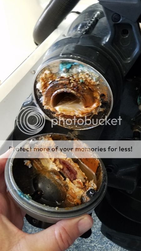

    Here’s inside a g2 tilt tube with the rust and corrosion option.

    Yikes
    Freagin salt!
    Quote Originally Posted by baja200merk View Post

    Water intrusion around the cap? Salt water maintenance schedule for greasing

    I have been trying to buy all my used parts from up north for that reason, the 1981 50hp gearcase housing i got from MN was like working with a new part... I ordered the 2.7L G2 tiller and lower mount shoe yesterday see if it fits.. That g2 swivel must cost a fortune to mfg compared to the std trim unit..
    Geez, how many hours rough were on that?

    Quote Originally Posted by Greg G View Post
    It’s got a 10 year warranty... Who cares?

    No questions? Lack of maintenance etc

    It was 100% covered new clamp and swivel was installed.

    No grease goes there and the cap/ screws have o rings, but a shot of lps 3/grease or something like that would have helped prevent that for the most part, but that would cost 2cents more.. and now they pay 10000 times more on warranty , bean counters..

    So that nipple doesn't feed the whole assembly and spill to the inner cap when full?

    no it greases the wear plate between the mount and swivel bracket,

    I believe theirs a service bulletin pertaining to those caps. They had a production issue where the o-rings were getting pinched and weren't sealing properly. But like Kevin said, 10 year warranty, who cares!
