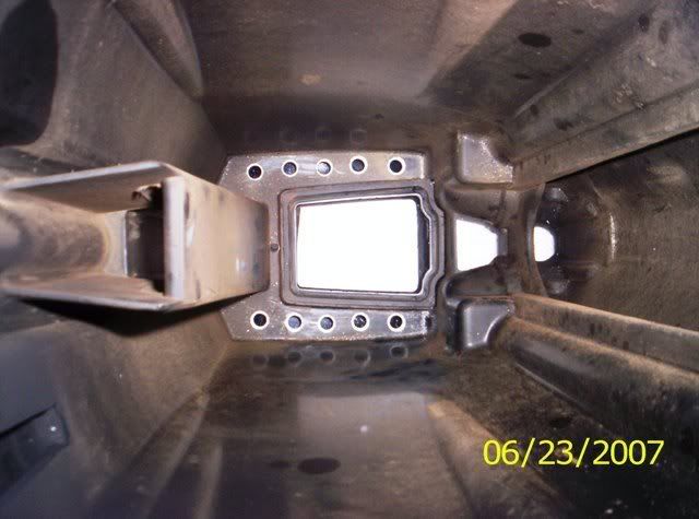

    Sorry wasent keeping up but heres the pic of 1 i copied, its a lot easier on a drill pressClick image for larger version.

    I've done them like this, and I've also trimmed the flanges off like the skip mod and cut big oval holes. Either way, the relieved straight leg mids sound more "Merc-y" than the offshore dumps (which have more of a howl) IMO. They also direct the sound down instead of rearward, which makes them a lot less ignorant when you're idling around the dock and boat ramp.

    My O/S mid is submerged when idling. But cuts loose when you come up on plane.

    I did this mod to my 2.4 200. Love the sound

    Tried it today was great!! Not bad mid range only when I trimmed her up louder but a good kinda sound. Love this mod!!

    Is there enough material thickness where the 10 holes are drilled to tap them say 1/2-20 and then install some bolts for when you want it more quiet?

    Yes there is room ,
    I wondered the same thing. Tap for 1/2" from above. Then run internal hex pipe plugs if needed from below later
