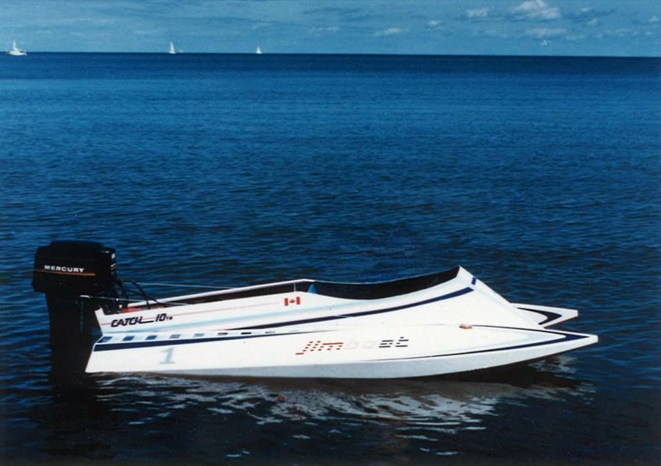

    Here's the original 10ft design with a stock Merc 25. Rev. Ronnie owns it now. Corners like mad, but sticks to the water too much without some light chop or breeze.

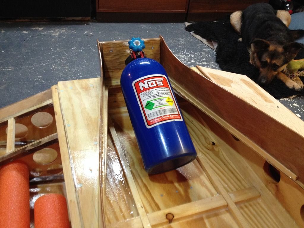

    I always wanted one of those as a kid. They were made by Grew up here.
    Any pics of that nitrous set up? My next one is almost ready and I have a stripped down late 70's 20hp Merc to try on it.

    No pics but pretty simple. 1 NOS fogger screwed in the manifold behind the carb, T in the fuel line running to an elect. pump which supplies separate fuel for the N2o solenoid at 5psi. Can't remember the jet sizes without pulling'em out but they're around .028/.032!

    Thanks! I have most of those parts kicking around.
