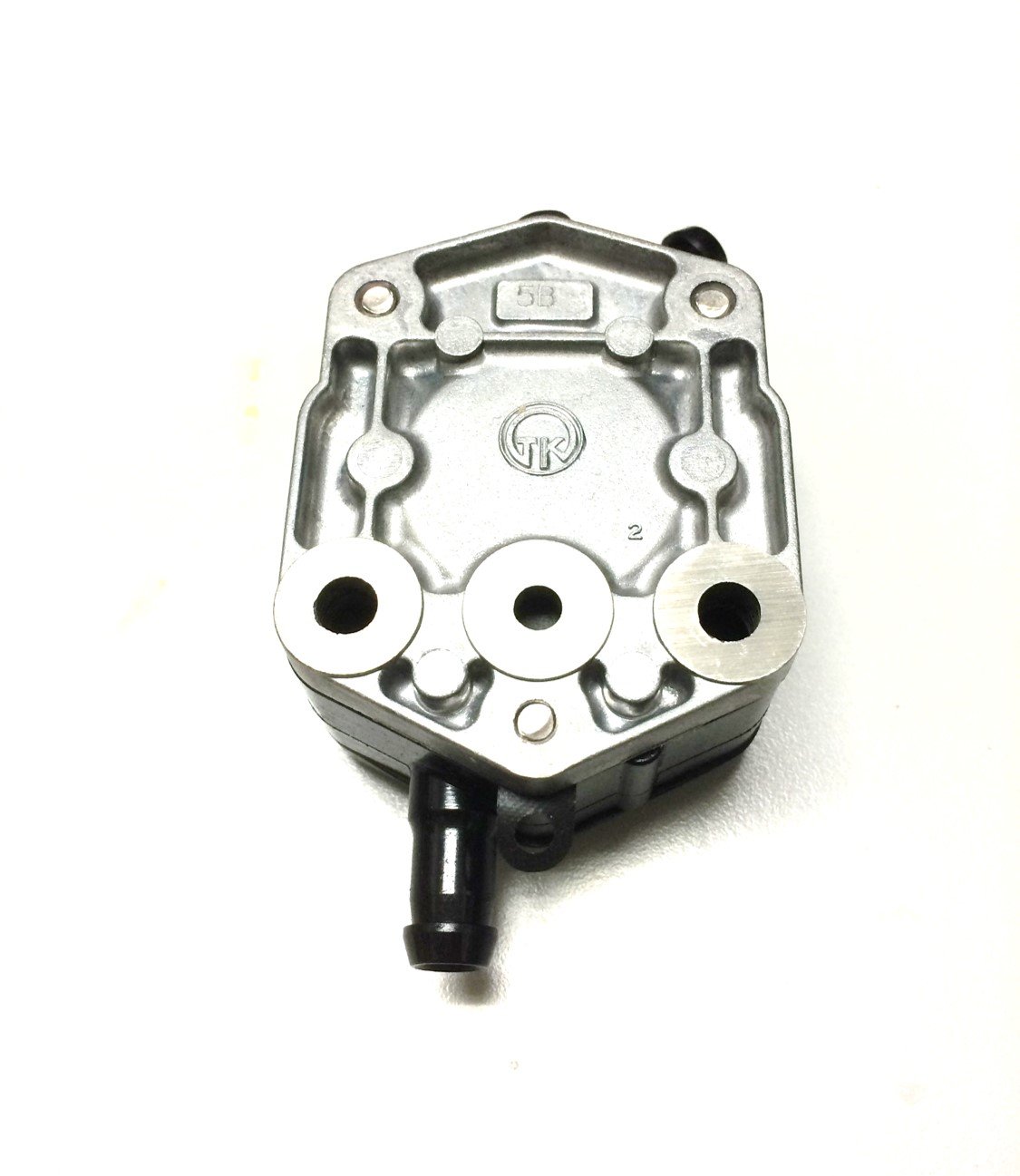

    I have a 1994 140 Looper and would like to delete the VRO pump.
    I would consider an electric pump but prefer this pump:
    Azure AZ259, 8.1

    After doing extensive research I'm leaning twords this yamaha fuel pump. I've been told there is enough material in the signal port that I can thread it and insert a pipe for connection to the pulse hose.
    Its used on 115hp to 300 hp Yamaha v6 so it should flow enough.
    Sierra Part #18-7349. $30

    But the v-6's use 2 pumps. If your lucky it will be enough for a v4 looper. Put in a fuel pressure gauge so you can monitor fuel pressure at WOT.

    I've ran dual yamaha pumps on a v6 omc, works great and dirt cheap on ebay.

    Do you happen to know if the V6 has those pumps in series or if they're running parallel?

    Parallel. 1/2" fuel log vertical, the 3 carbs are fed separately with 3/8" hose from the log. One pump feeds the log from the bottom, the other pump from the top.

    Just cap the oil line and run the vro as a fuel pump only works great and its FREE

    I did this on my 140 for two seasons and had no fuel problems. Gary

    I'll try blocking it this weekend and report back.
    I found a hole in the pulse hose going to the vro. Most likely that was causing my issues.
