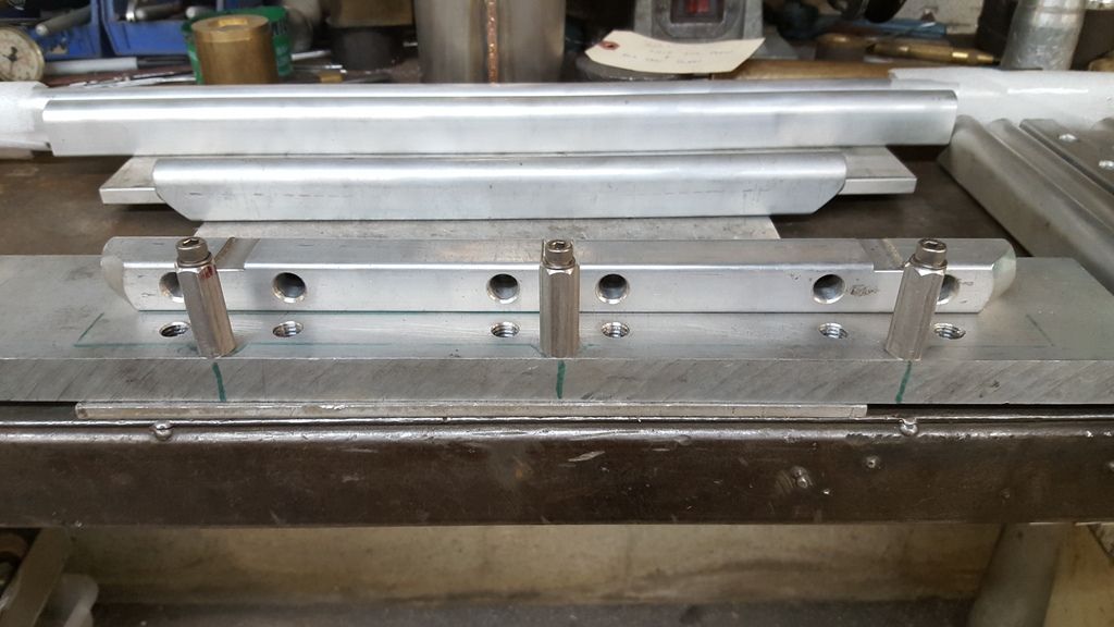

    X as in 300x .. The fuel rail / regulator is NLA ... However ....
    Drill / mill jig ....
    Turns into a weld jig ..... how many would you like .. ?
    If your a good boy .... I might even do one for a OMC every once in a while ....

    Sure you have all injectors lined up
    so easy..
    send you a photo of mine later
