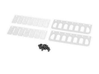

    There is a 2.5L Carb motor listed in Mercury's parts catalog that uses 7 petal reeds. I don't know what horsepower it is. It is just listed as 2.5L CARB in the parts catalog. The diagram shows 5 petals, but it's generic. If you search the part number, it comes up 7 petal. 34-815242A3 Reed. 87692--2 reed block
    It lists carburetors part numbers as:
    3311-818650A19 1 CARBURETOR (TOP)
    3311-818650A20 1 CARBURETOR (CENTER)
    3311-818650A21 1 CARBURETOR (BOTTOM)
