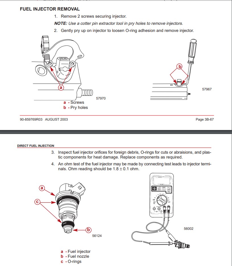

    I recently got asked by a forum member here, on how to properly remove fuel injectors and direct injectors from an Optimax motor. I have attached some snippets from the service manual (this particular manual was for a ~2008 225 Optimax, manuals may vary)
    Removal of the fuel injectors (usually red in color), avoid using vice grips or screwdrivers to pry on these, the plastic connectors may be damaged.
Name:	Optimax Fuel Injector Removal.jpg
    Once the fuel injectors are removed you can remove the 2 lock nuts from each fuel rail. I believe they require a 15mm socket for removal. The fuel rails can now be separated from the direct injectors, and cylinder heads. V-6 models have 2 fuel rails, while the smaller 3-cylinder models only have 1 fuel rail.
    Here you will see the instructions on how to remove the air or direct injectors. What this part of the service manual is missing is the special tool, I have listed it below. You should be able to tell if the Teflon ring has been leaking, there will be signs of combustion on the ring. Regardless, on our services the ring is replaced.
Name:	Optimax Fuel Injector Removal 2.jpg

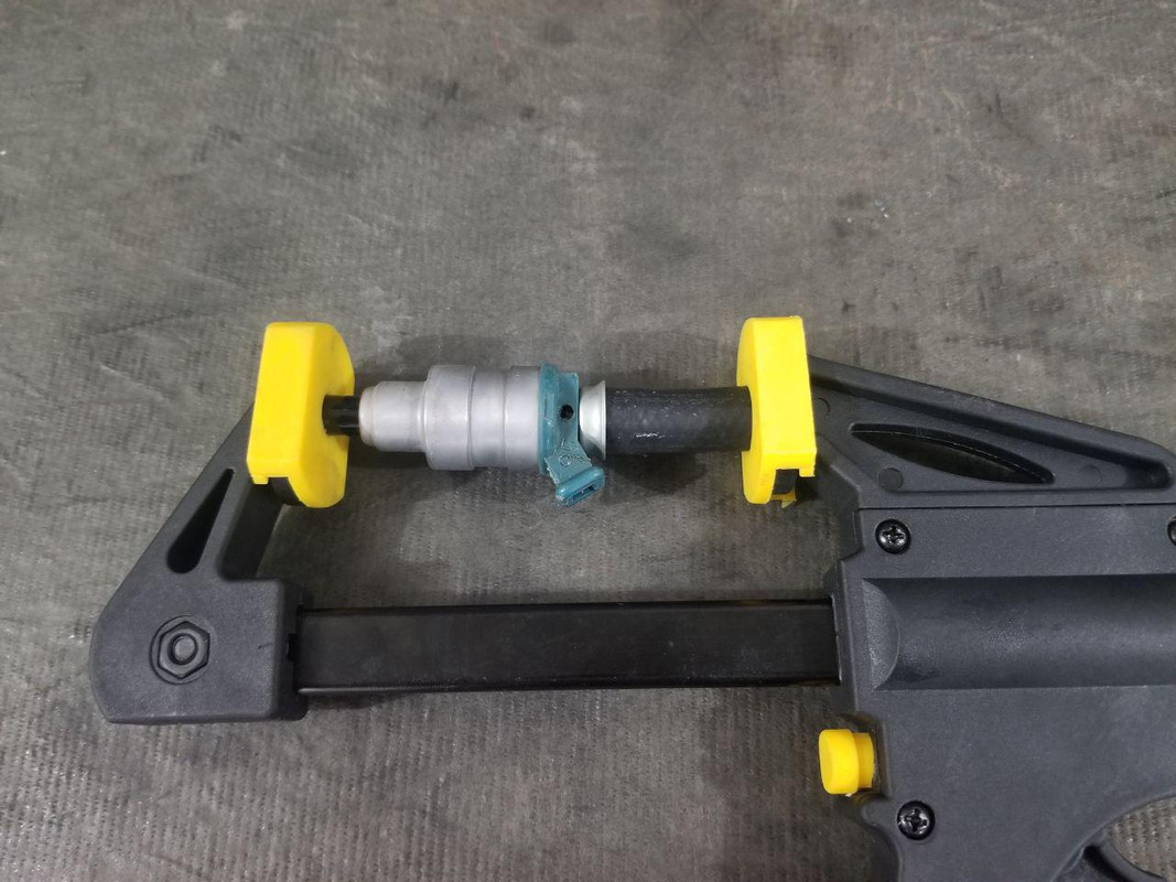

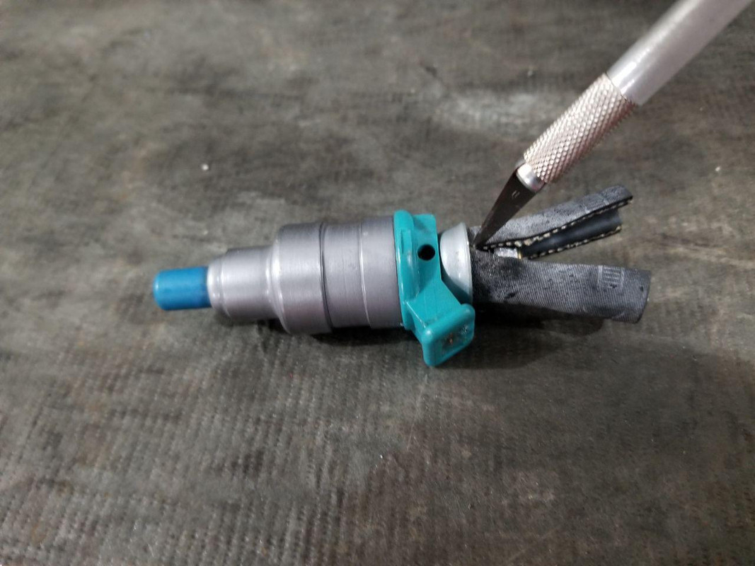

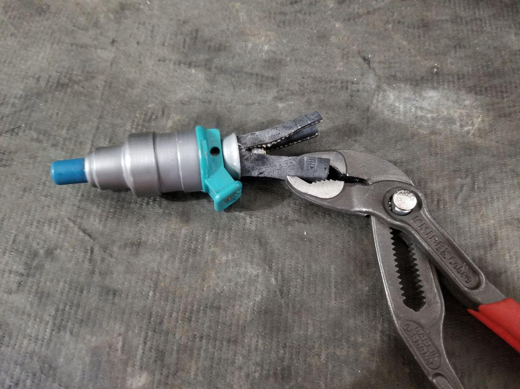

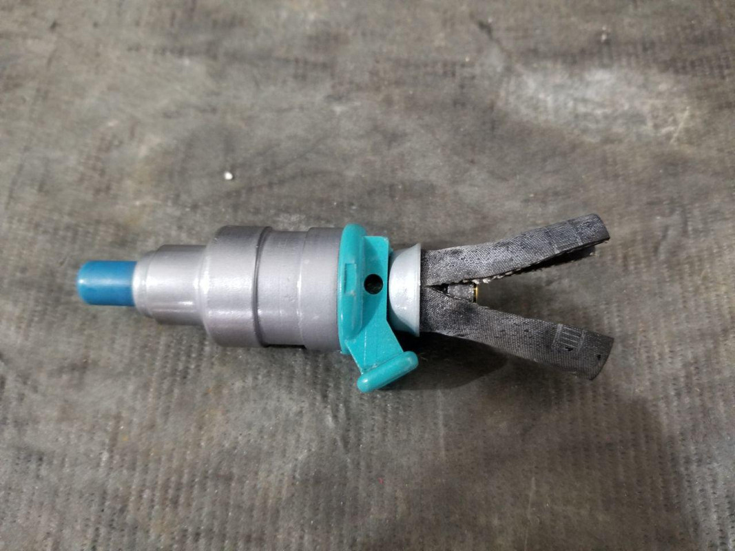

    How To Replace Hoses On Mercury Hose-Feed Style Injectors
    I hope you guys all had a Merry Christmas! I wanted to leave a little tidbit of information on how I replace the hoses on the hose fed Bosch injectors found on Mercury motors. I'm sure a lot or most of you know how to do this but hopefully someone is able to be helped by this.
    First off a quick history on this injector. The injector is made by Bosch, and has part number 0 280 150 036. These injectors were originally found on some early to mid 70s Jaguar, Mercedes-Benz, and Volvo cars. If you look at the fuel rail on those cars they have a very similar design to the Mercury fuel rails. Bosch quit manufacturing these injectors in 2007, although I believe Mercury still has some available (at a pretty high ridiculous price tag).
    1. The first thing you need to do is remove the old fuel hose. I cut the hose down the middle on each side with an Olfa knife. You could do this into 3 or 4 sections if you want but I find this works well and is the fastest.
    2. Here you will see the hose cut into 2 pieces and pulled apart by hand, if you try to remove the hose now, it may come but will be very difficult. Most of the time it won't come at all.
    3. Next you need to get in with a small art knife. You won't be able to do this with the Olfa knife, you can't cut deep enough. You need to cut all the way through the braided middle portion of the hose
    4. Now you can grab your pliers, and pull off each side. Usually they come off 1 at a time. Make sure you pull away from the barbed end of the injector, not towards.
    5. Here you see the 2 halves of the hose, as well as the ferrule. The ferrule is reusable. Do not cut it if you don't have to. They can be difficult to find, and must be used for re-assembly.
    6. You can now reassemble the injector, with the original ferrule, and a small piece of fuel injection rated hose. Do not use the low pressure hose that feeds from your fuel tank, it must have the center braided portion. I cut these to 1.5" long.
    7. Here you will see how I assemble the hose onto the injector. The hose is pressed tightly against the ferrule. The ferrule is there to keep the hose from expanding and sliding off the barbs.
    7B. This picture shows how I have modified my clamp simply by drilling a hole partially through it. This end is placed on the pintle cap. This prevents the pintle itself from being bent or damaged in this process. Do NOT clamp the injector if you have not done this. Alternatively you could use a small piece of pipe or a socket over the pintle cap.
    8. This is the final product. Looks like factory.
