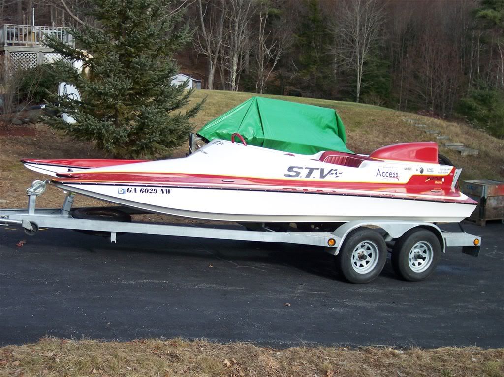

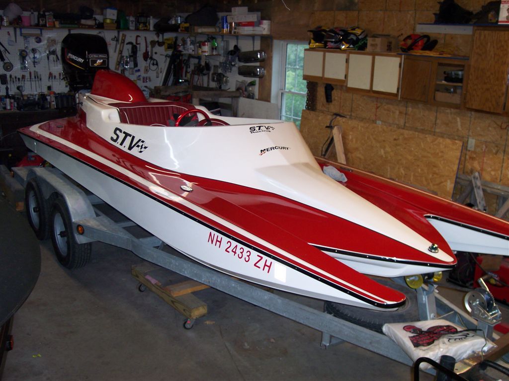

    It's a factory trailer (as far as I know). These are pics when it was stock. By changing tires, using a lowering kit and dropping the bunks, I dropped it about 5 inches. If I move the fenders out some, I can drop the bunks another 2 inches. That will work for my needs, but will put me at 8 about inches between skeg and the ground. I run 6 inches of setback, which makes it worse.
