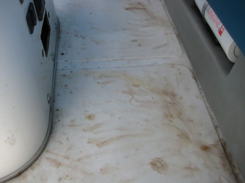

    Darn LEAF STAINS!!! (pic)
    I just purchased a 14ft Boston Whaler and the deck has brown stains on it. The previous owner let the boat sit under Oak three for a few months uncovered and the leaves left behind brown stains all over the deck. How do I get the stains out? What do I use? Thanks

    Hey
    Try a Mr Clean Magic Eraser

    Its made by marykate, Its called On & OFF Gel... It is some bad stuff, will pull that right out FOO SHOOO!!!!

    The sun bleached out some black olive tree stains in my dad's old boat

    Comet and scrub brush, works great on nonskid.

    Westley's Bleache White whitewall cleaner, just cleaned up my 13 foot Whaler over the weekend.....

    Clorax or any cheap bleach. Mop it on let it sit, rinse it off.

    Soft scrub is liquid sandpaper. It will scratch the hell out of it, and allow it to stain much easier next time.
    Bleach, Iron-out or Lime-away should have a good effect.

    Try some toilet cleaner.....I have a Cape Horn center console and use some stuff called Sno Bowl....Does the trick.

    Thanks for all of the replies guys. I really like the one where all I have to do is let it sit in the sun.

    LOL not kidding dude...it really worked

    try rust-aid home depot...it'll take that right off...it took all the goldish stain on the bottom of my boat like nothing...

    (on and off )cleaner works well on cleaning gell coat. This stuff cleaned the old exhaust stains off my transome (stingray) with just spraying on, let it soak(5 minutes) and spray it off. Great product!
