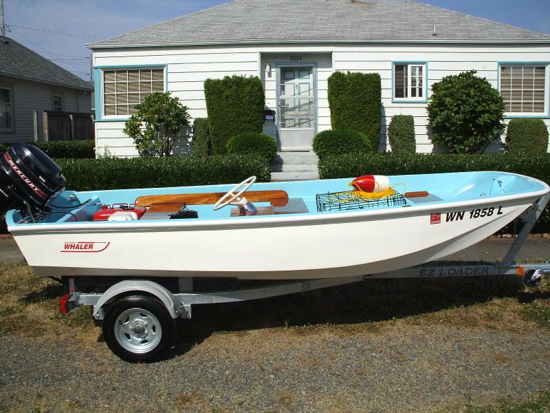

    I spent most of the winter working on the 1965 13' whaler that my son and I got last year. It was actually pretty nice when we got it considering the age, it had be garaged most if its life and is a "dry and lite" hull. However, I wanted to make it a bit nicer and thought it would be a great father and son project.
    For the most part it is pretty original (the only totally new things are the rubrail, the "whaler" stickers, and the trailer) the finish is all gelcoat and was the most work of the project. I mostly did small repairs wherever it need it. There were quite a few chunks where metal gas cans were put in without mats, the bottom was pretty rough from beaching, and the transom need some work. We completely derigged the boat and had a local glass shop color match some blue and white. We did the transom sides and inside first when it was still on the old trailer. Then we flipped it onto a dolly and did the bottom. I only found one soft spot and rapaired it with glass and then coated it.
    We then filpped it right side up on a new trailer. In the mean time we completely sanded the mahogany and revarnished it with about a dozen or so coats (I actually lost count as I was gettin up at 5 am to do one in the morning, then I would do another at night after work ).
    We cleaned and/or polished every fitting and replaced the steering cable.
    The old merc is also in pretty good shape other than we were having a overheating problem, even with a new impeller. I ended up pulling off the side case and found about 30 years of gunk causing the water flow problem. I replaced the plugs and fuel lines, cleaned up as much as I could and put it back on.
    I also made a little dash panel in the console so I coul mount a kill switch, which was a little tough on the old merc and had to get out the soldering iron
    We still have a couple of things to do, like ad navigation lights and such.
    I would also really like to fit some sort of motor trim, but don't want to add one of those setback trim deals, so I am still thinking.
    here are some pics of what it looks like now:

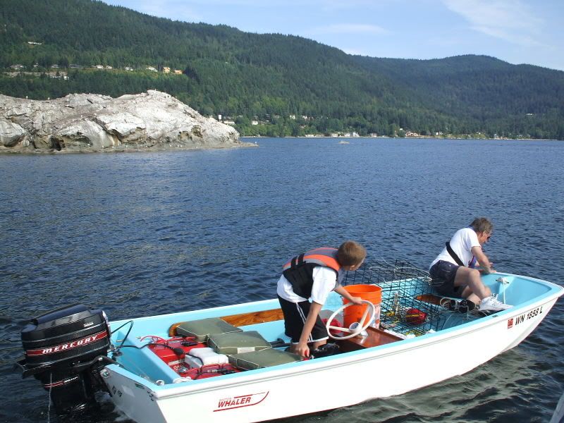

    My son and daughter at the slip:
